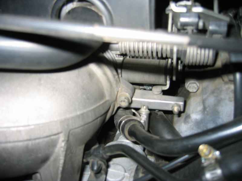

On my car, which has ASC, the hose attaches to the throttle body below and to the driverside of the elbow. Not sure of the part number, but you could probably just get by with some hosing from a local auto parts store as I did. Here are some pics. The first shows where that hose attaches to the throttle body. The second two show the whole thing installed. It's really crowded in there when everything is put together.

I would first try changing it without pulling the manifold, but there's so much stuff in the way you probably will end up doing it anyways. Change the intake gaskets and PCV plate while you're in there.
