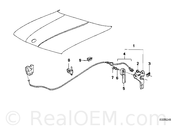

    Default Diagrams
    Quote Originally Posted by Qube
    We've listened carefully and there is no sound :| Now the key question is what exactly happens when you pull the latch? What is released where?
    IMO there can be two issues, one, when you pull the handle inside the car, the bowden cable (see diagram) is no longer connected/broken, and not releasing the latch.
    Or, there is a problem with the hood lock, #5 in diagram, where it may be seized, and not unlatching. This is where the hood is kept closed/latched.

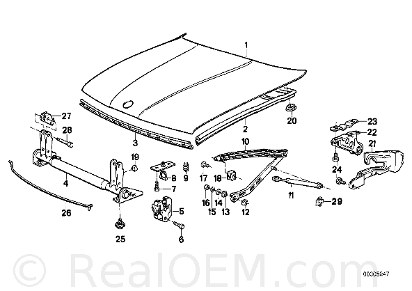

    Again, my apologies, but would these issues contribute to the picture above? I mean it's just that part by the windshield that seems to be keeping it shut like a stale clam. I just can't wrap my head around the fact that if all the parts by the windshield are stationary and the latch has no bearing on them at all, why is it stuck? I bet you it'll turn out to be something stupid (a la Bill R explaination) like the pivot being so rusted that it can only lift the hood up and not out. Okay, thanks guys. Once I get back to his car this weekend, I'll work on it.
    EDIT actually, the rollers are sitting under that groove in part number 21 (second pic). I can't pull it to get it out from there. Anyway...
    Quote Originally Posted by saj3n

    Can you get it 'up' enough to reach the pivot pin bolts #28? If you could remove those, the front of the hood would be free from any mechanical connection to the body of the car (other than wiring and the washer hose). That might allow you to remove it and then see what's really going on in there.
    I'm assuming through all this that since the hood can pop 'up', (2nd pic) #8 is popping out of the latch, #5. That should be visible with the hood popped up. As long as that #8 is wholly visible, you don't really have a latch or cable problem.
