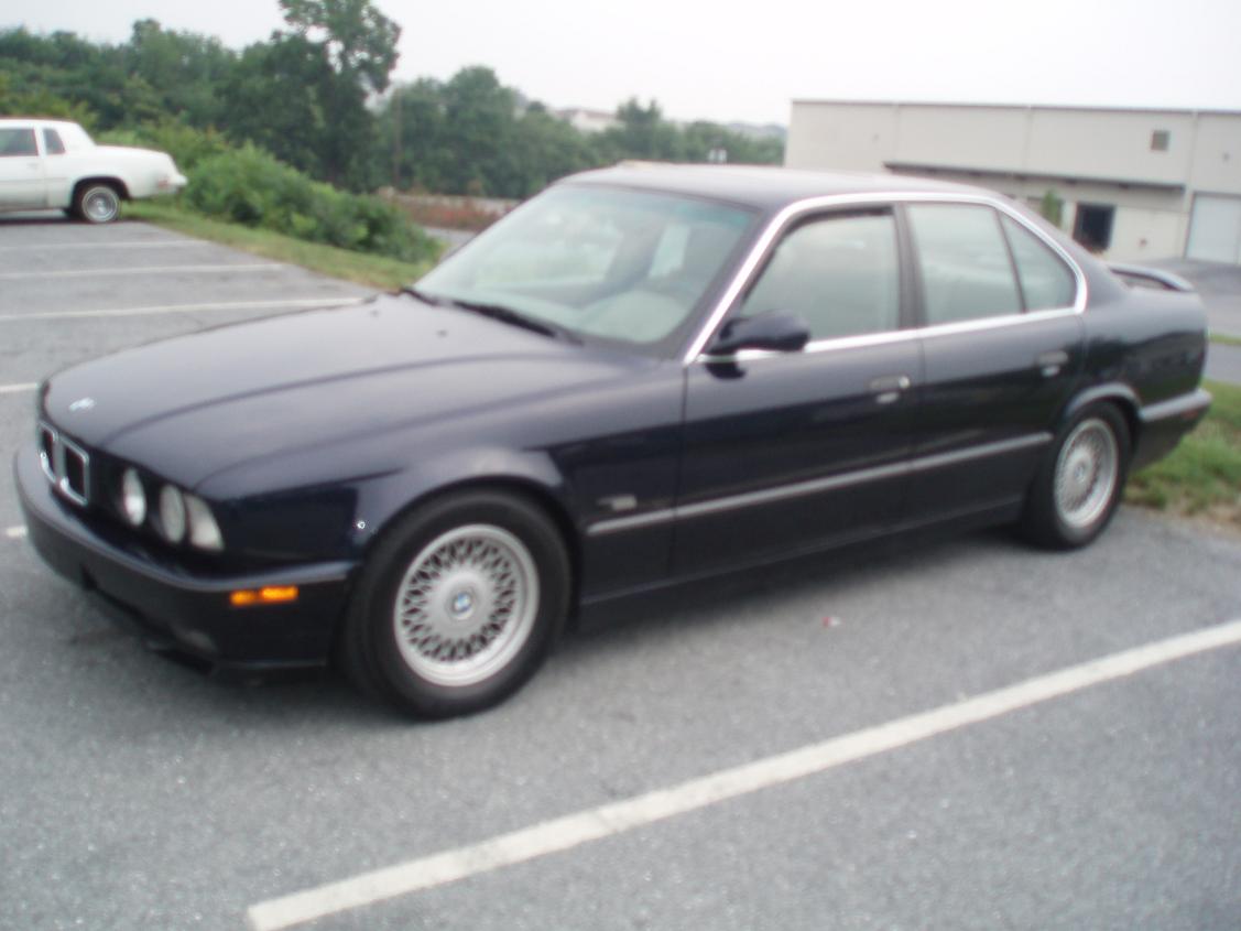

    Tiger, I posted the pictures. Awaiting your evaluation...
