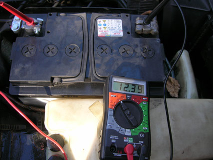

as you can see, there is not a lot of room for expansion. there is zero room towards the rear (of the car, + side of battery), the holes for the bracket towards the front would fit a battery precisely 35mm longer, and I think there is room for a taller battery but not a whole lot.
really, i'm pretty sure anything even slightly bigger than the 94R would be a giant pain to fit. i don't think i have much of a choice.

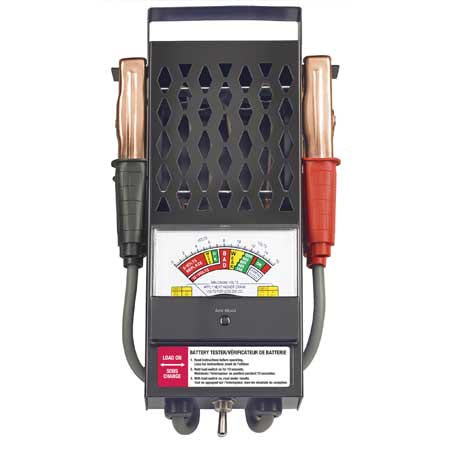

here's a good bit i forgot...
Boss- "This is the tester the company sends us."
LOL it was a motomaster! (generic canadian tire, probably your autozone equivalent)
edit - here's a pic of the exact tester i found on their website

If a 100A tester is just wobbling on the good line there could be a problem. Though! I'd be pretty sure its guage is calibrated against specific voltages at 100A pull.
