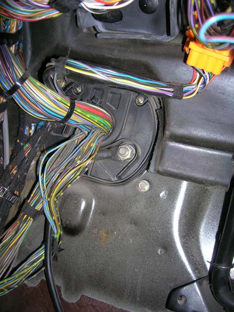

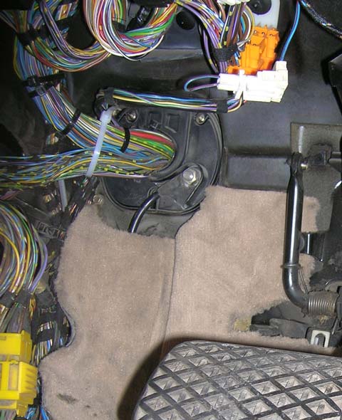

I have an ongoing voltage problem and I have been stumped for a good long time now. (this is 'charge trek' chapter XVII)
I'm going to look at this old security system that I found in my car after I bought it. This is the 3rd time I'm going to look at this- I thought I disconnected everything but maybe I missed something.

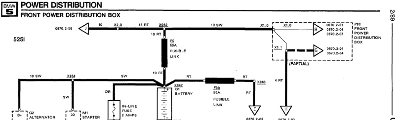

I'm looking for connector x1.0.
So what/where am I looking at/for? I don't remember seeing a big black wire - and what does "(partial)" mean?

Thanks- the hazards still flash (once) when I reconnect the battery ground but I can't find any more remnants. I think that means something is still connected somewhere. I've looked everywhere I think but I only found remnants attached to the ignition switch wires and the door lock wires - oh well that was a good little dig anyway, I'll try something else... p/o installed some silly 'euro' horns I might take a closer look at next.
