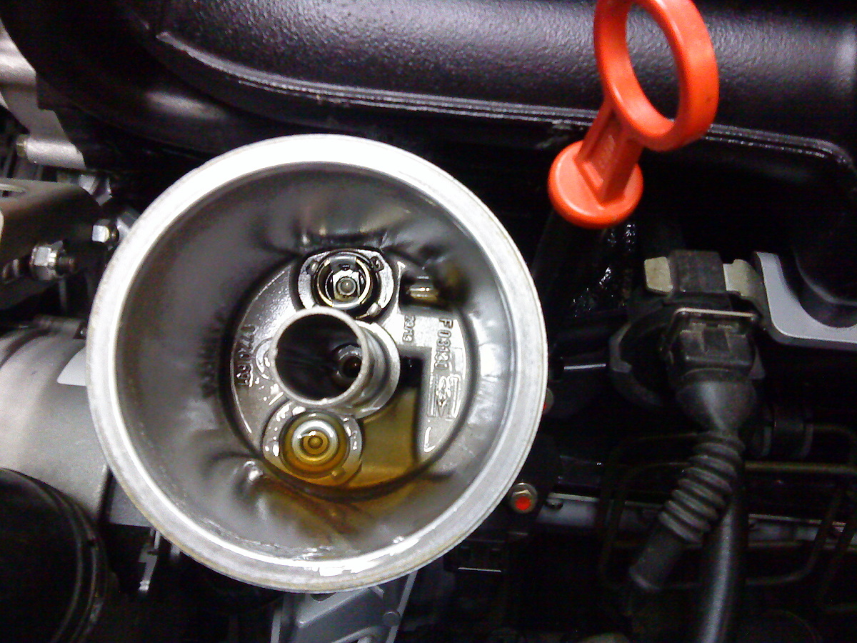

    Or the check valve in the oil container is gone = no engine oil in the oil container and it takes time to pump the oil from the oil pump to the oil container/pressure valve. Take the cover off after it sits overnight & if it is still full, it's not a checkvalve issue.
    this is the new oil filter housing http://www.exx.se/objects/bimmerforu...ilterhouse.jpg
    DIY repair http://www.bmwe34.net/E34main/Trouble/OilCanister.htm
    The oil filter holds the check valve closed when installed. Open the top and the filter will let the oil drain back into the engine.
    I installed a chinese filter and it was a bad design and crushed itself on instal allowing the oil to drain back when not running. I had the same issue as you until I got a real replacement filter (Mann) and the problem went away. Idiot light is non existent now. Let us know what you find out.
